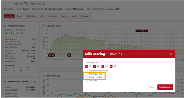

Input option 1:
Via Cowcard > New entry > Milk Setting > Training period or Priority feeding

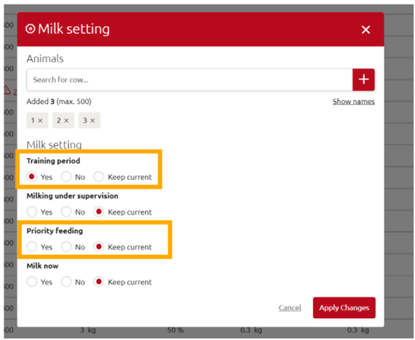

Input option 2:
New Entry > Milk settings > Select cows > Training period or Priority Feeding

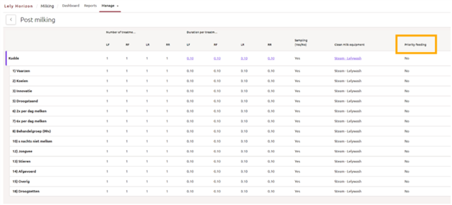

Input option 3:
Milking > Manage > Post milking > Priority Feeding
