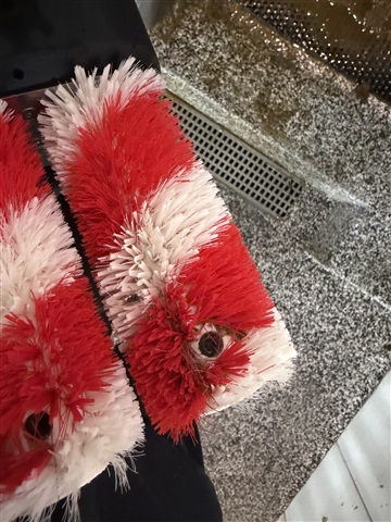

Can we adjust the time a dashboard alert is given in Horizon to replace the pre treatment brushes on an Astronaut A5?
Instead of 30.000 we found it should be about 15.000/ 20.000 when using USA pre treatment plus sand.
