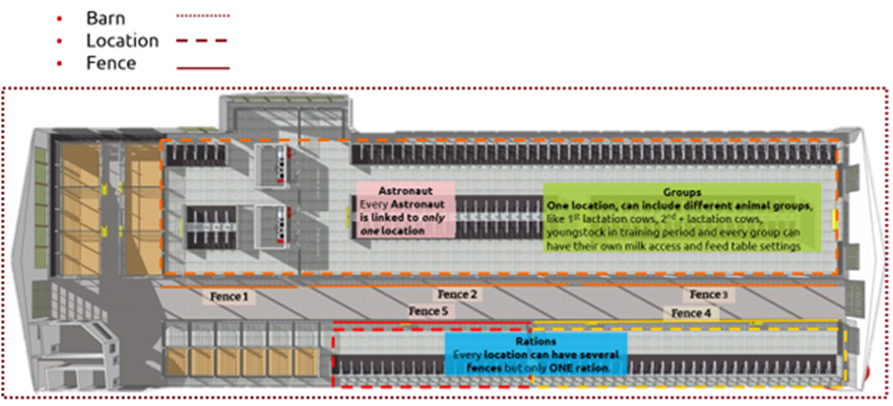

The Fence page in Horizon is designed to help you manage all your fences efficiently. A fence is a physical area where the Vector can feed, and it is located within a specific location in the barn. A barn can consist of several different locations, where one location is an area where a group of animals is housed and fed the same ration. Note that a location can have multiple fences, but all fences within the same location share the same ration.
Image 1: Barn floor plan  - dotted lines are locations, e.g. milking cows (orange), dry cows (red) and young stock (yellow).
