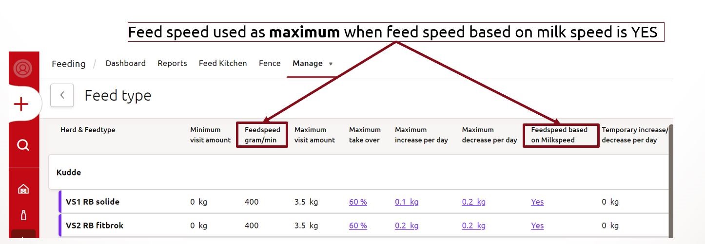

Settings in Horizon
The feed speed can be adjusted via the feed type settings in Lely Horizon. To optimize the robot visit for cows with a high box time and low milk speed, the option “feed speed based on milk speed” can be put on “Yes”. In that case, the Astronaut will dose the feed slower and according to the cows’ milk speed.
Cows with a very high milk speed will be fed at max feed speed, but they will not benefit from this setting, as the maximum feed speed will never be exceeded.
