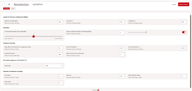

Step 1: Click Manage > Reproduction > Lactation
Step 2: The settings for autoheat are on the page, turn on the slider.
Step 3: Select ‘apply changes’ to save the changes
Lactation settings
Lactation settings are used to manage the cow touches during lactation based on the reproduction status. They can be found via Reproduction dashboard > Manage > Lactation. This page allows you to set the voluntary waiting period, settings around heat indications and attentions, settings around pregnancy checks, automatic pregnancy confirmation and settings related to calculation of dry off date and expected calving.
With these settings adjusted according to your needs, they can be used as input for tasks and/or routings to make sure the cow is in the right place at the right time.
How do you adjust the lactation settings?
Length of voluntary waiting period
Length of voluntary waiting period – Through this setting, you can manage the age at first insemination and the voluntary waiting period (VWP) for lactations 1 and 2+. This determines when cows appear in the heat & insemination tasks and in report 19. In report 19 you can include or exclude VWP cows.
Heat (day)
Threshold attention heat probability – This setting determines the heat threshold at which cows show up on the heat & insemination task (report 19) and determines the heat threshold at which the heat push notifications are sent.
Days no attention after insemination/heat – Via this setting you can manage after how many days a cow can show up again on the heat and insemination task (report 19), after a heat or insemination. Default is set at 10, but 2 or 5 days is also often used. In general, the goal is to reduce the number of cows in this task, but it can be a management decision to reduce the number of days, as some farmers would like to see their cows more often. Or in specific cases, it can help to reduce this number, for example, if you have a cow inseminated on day 60 and when she has a heat detected after 2 weeks she appears on your task, and you decide to inseminate her again. If she is in heat one week after her second insemination (21 days cycle), you may want to inseminate her again, but in this case, she will not appear on the task.
Automatic heat registration – When this setting is turned on, heats will be registered automatically. Find more information here.

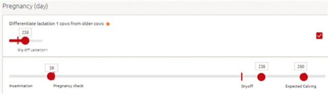

Pregnancy settings
Days after insemination for pregnancy check – This setting determines how many days after insemination a cow will show up on the reproduction/pregnancy check task (report 34).
Dry off lactation 1 and 2+ – This setting determines what the expected dry off date will be for a cow. For dry off related settings, click here.
Expected calving – This setting determines the expected pregnancy length which is related to the calving task (report 31).
Reports before dry off/calving – This setting determines how many days before expected dry off and expected calving a cow will show up on related reports (31 & 32) and tasks (dry off & calving).

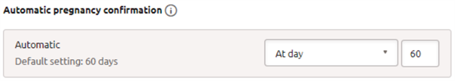

Automatic pregnancy registration
Automatic pregnancy registration, automatically registers cows that are pregnant based on days since insemination. The goal of this feature is to reduce the number of cows on the pregnancy check task, reduce manual data entry and to keep KPIs like ‘pregnancy rate’ up to date. There are two options for automatic pregnancy registration, both are explained below.
A list of cows marked with automatic pregnancy, can be easily found in the default report ‘animal event overview.’
How do you turn on automatic pregnancy registration?
Step 2: The settings for the two options are displayed in this menu.
Off – No automatic pregnancy registration occurs
At day – This option designates the cow as pregnant at x days after insemination, with the ability to customize the timeframe. It only considers inseminations and disregards heat behavior. Therefore, even if a cow exhibits heat behavior, she will still be marked as pregnant after x days, unless there is a new insemination.
Absence of heat – This setting marks animals as ‘autopregnant?’ at day 42, and as ‘autopregnant’ at day 48. It does take into account activity data, as well as manually entered heat and inseminations. Which means that if an animal is in heat, the animal will not change status to ‘autopregnant.’ A heat is defined as 8 hours of consecutive heat probability above the threshold.

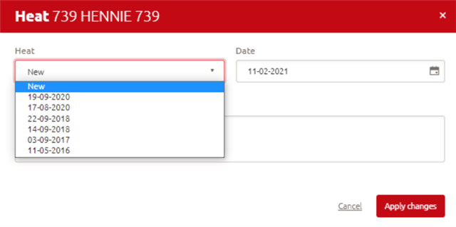

Step 2: Click + -> Heat
Step 3: A new window opens where you can:
Choose the applicable action (create or edit heat) in the ‘Heat’ dropdown menu and Select the date to register the heat on the calendar.
If necessary, enter a remark by clicking the textbox.
Step 4: Click Apply changes to save the changes you made

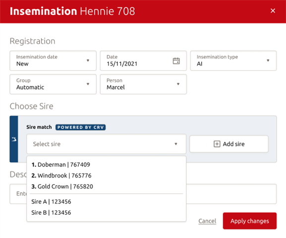

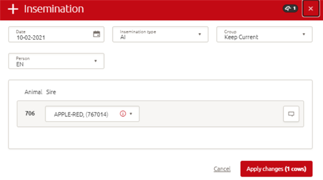

Step 2: Click + -> Insemination
Step 3: A new window opens where you can select:
- The insemination date;
- The insemination type;
- A group of the inseminated cows;
- The person who carried out the insemination and
- The sire used for the insemination.
Step 4: Click Apply changes to save the insemination

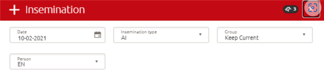

2. Multiple cows
Step 1: Select the cows to register an insemination by:
Selecting the cows in a task or
Selecting the cows on a report (e.g. repro report).

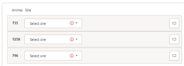

Step 2: Click + > Insemination
Step 3: A new window opens with the total number of cows selected shown in the upper right-hand corner. In this window, you can register or set the following for all cows:
- A group of the inseminated cows and
- The person who carried out the insemination.
Step 4: Select sire used for each individual cow in the list as below
Step 5: Click Apply changes to save all inseminations

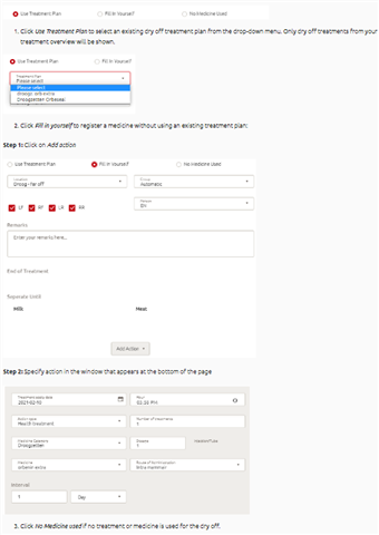

Register a dry off
To register a dry off in Horizon and change the relevant settings to your preferences.
Important work routine!
- Always enter treatment in Horizon before treating the cow
- Always be sure that if milk separation is needed, milk separation settings are completely confirmed (see step 6)
- Be sure that antibiotic milk is separated from milk in the bulk tank, make sure that all medication is entered into the Medicines Library in Horizon and check the proper waiting time for milk is entered in hours!
How do you register a dry off?
A dry off can be registered in two ways:
1) An individual cow
2) Multiple cows
1. Individual cow
Step 1: Select the cow to register a dry off by:
Going to the cow card; Selecting the cow in a task (e.g. dry off task) or Selecting the cow on a report (e.g. 32 – Calendar – Expected Dry Off).
Step 2: Click + > Dry off
The dry off date The dry off time

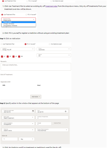

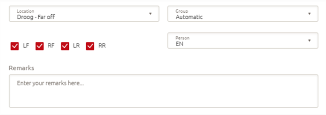

Step 4: Choose one of the three dry off options:
In this window, select:
The location of the cow; The teats that are dried off; The group of the cow and The person who carried out the dry off.

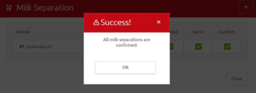

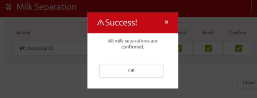

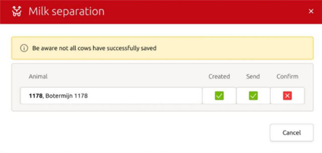

Step 5: Click Apply changes to save the dry off. A confirmation screen appears for the milk separation once all 3 actions are confirmed (Created, Send, Confirm).
Note: if milk separation is not confirmed, do NOT milk the cow; first contact your Lely Center.

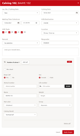

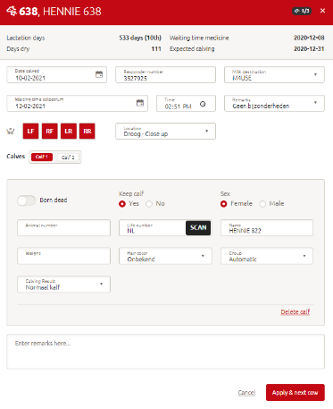

Step 2: Click + > Calving
Step 3: Change the settings according to your preferences in the new window that opens. Milk separation, animal location, calving remarks and information about the new-born calf can be entered here.
If there is a twin, you can click on Add calf and an additional information page for calf 2 will appear.

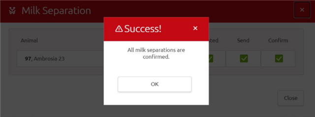

Step 4: Click Apply changes to save the changes. A confirmation screen appears for the milk separation once all 3 actions are confirmed (Created, Send, Confirm).
Step 3: Change the settings according to your preferences in the new window that opens for the first selected cow. Milk separation, animal location, calving remarks and information about the new-born calf can be entered here.
The total number of cows selected is shown in the upper right-hand corner of the window.
Step 4: Click Apply & next cow to apply changes for this calving and move on to the next.
Step 5: Click Apply changes after you have been through all calvings to save the changes. A confirmation screen appears for the milk separation once all 3 actions are confirmed (Created, Send, Confirm).

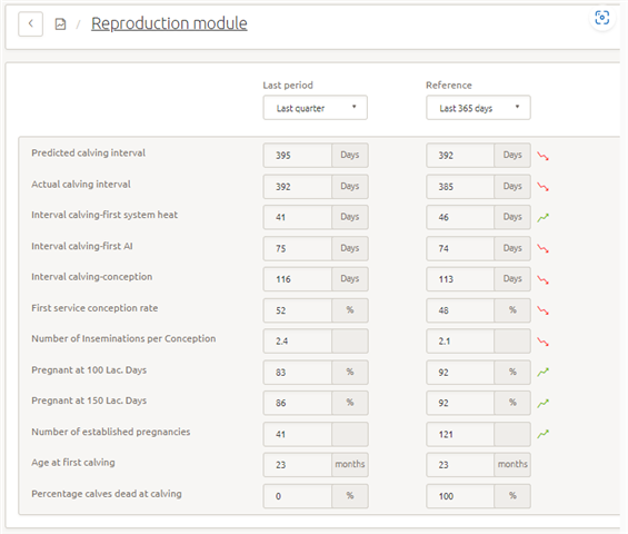

Reproduction analysis
This analysis provides an overview of the actual reproduction indicators for the last year, last quarter, or last month. In this article, we explain where to find the analysis and how to use it.
Where can you find the reproduction analysis?
Go to the reproduction dashboard and navigate to the reports tab. The reproduction analysis button can be found at the top of the page.
How do you use the reproduction analysis?
In the analysis, it is possible to compare multiple time periods by changing the time frame at the top of the page. The time periods available are 30 days, last quarter, and last year. In the reference column, it is also possible to select ‘reference.’ This will result in empty cells, which can be filled in with your reference or goal value. The values will be remembered for when you select ‘reference’ next time.
The pregnancy rate explanation and calculations can be found here.

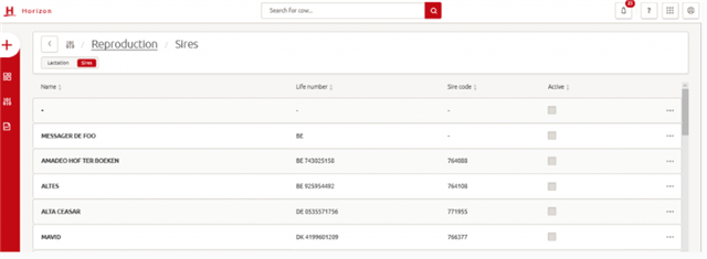

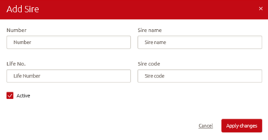

Step 1: Click Manage > Reproduction > Sires > + > Sire
Step 2: A new window opens where you can enter:
- The number of the sire;
- The name of the sire;
- The life no of the sire;
- The sire code and
- If the sire is actively used or not.
Step 3: Click Apply changes to save the changes you made

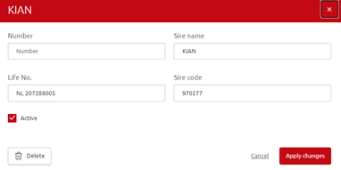

How do you edit a sire?
Step 2: Click the sire you want to edit.
Step 3: A new window opens where you can edit:
- The sire code and
TIP! Keep the sire list up to date. Sires which are not used anymore should be de-activated in the library using the edit button. This will keep the search list within the insemination screen shorter/clearer.

Sire advice
Choosing the best bull for a cow can be a challenge. Farmers use programs such as SAP (Sire Advice Program from CRV) to identify the best choice for each cow. Farmers that are part of the SAP can make use of the sire advice in Horizon. When choosing to inseminate a cow, the top three sire choices according to SAP are shown in Horizon. This means that the farmer does not have to find the SAP advice in VeeManager first, but can use Horizon to find the sire advice directly from SAP.
Where can the sire advice be found?
For a single entry: Cow card > + button > Insemination > insemination screen will pop up > click on dropdown arrow > click on first, second or third sire choice
For batch entry: Dashboard > + button > Insemination > insemination screen will pop up > select cows for insemination > click on dropdown arrow to find the top three sire choices per cow
Other remarks:
- Sire advice is available to farmers in Benelux countries who are in the SAP programme provided by CRV
- The sire advice comes from CRV, and CRV will be notified of the final sire choice
- Sexed semen options will be included in a later version
- In the future, other countries and reproduction companies will obtain access to the sire advice
- Enable connection to third party: Manage > Data exchange (Join Data)
