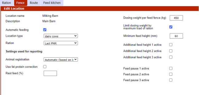

If you see any deviations in the points above, you can act directly on them by checking the Vector feed settings in T4C.
Fence settings is the place to see the set feed height, dosing weight and feed pause.
The feed height level depends on a combination of feed places, number of cows and feed intake. So, if the feed intake changes, you can act directly on this by lowering or increasing the threshold of the feed height. A feed pause can be useful in a situation when do not want the Vector to feed the cows during a certain period of time, but you still want the Vector to push the feed to make sure it is in reach of the cows.
Always bear in mind you need to serve several fresh portions of feed during day and night, so that cows always have fresh feed available.

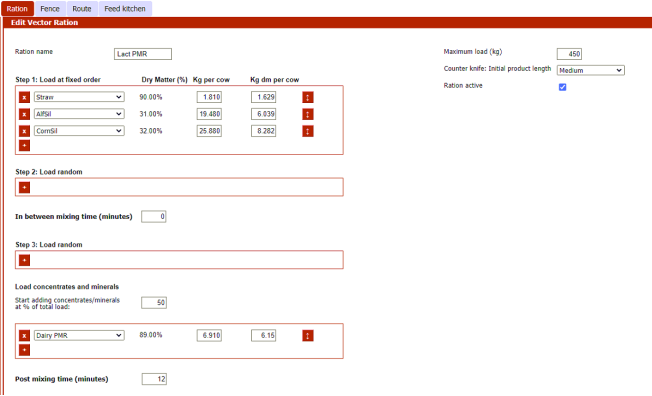

If you have noticed sorting behaviour of the cows, you can easily adjust the ration settings in T4C. Settings like loading order and mixing minutes can improve the mixing quality directly. If you have very dry feed stuffs, consider adding water to the mix to ensure minerals stick to the roughages.
When working with long and dry materials, put them in first and add the other shorter feed types in step 2. You can even decide to use the in-between mixing time for feedstuffs that need more intensive cutting. Make sure not to finish with long feed types (last grab), since they tend to float on top of the ration and therefore establish lower mixing quality. Putting a heavy/wet feed type in last will give that bit of extra pressure to improve mixing behaviour.
General Guidelines for Mixing Times
Ration with overall short feed stuffs (high concentrate rations): 2 – 5 minutes
Ration with overall medium feed stuffs (corn / grass silage): 6 – 10 minutes
Ration with overall long feed stuffs (round bales, uncut materials): 10 – 15 minutes
Also, make sure not to overload the MFR, as this will negatively influence the mixing behaviour and decrease the quality of the mix.
